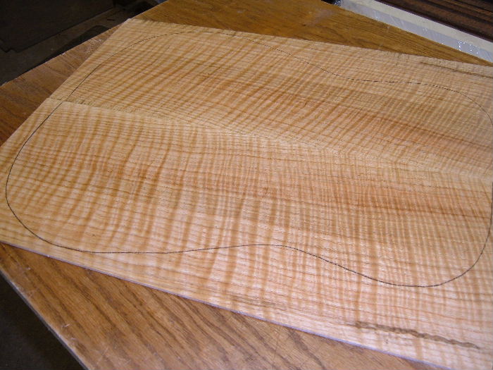

How 'bout some American Rubra? On it's way to GAL with a twin

[QUOTE=Larry Davis] How 'bout some American Rubra? On it's way to GAL with a twin
Larry is that curly red oak? I know Rubra means red in Latin. You carry that on your site? I love read oak more then I love white.

[QUOTE=Michael Shaw] [QUOTE=Larry Davis] How 'bout some American Rubra? On it's way to GAL with a twin
Larry is that curly red oak? I know Rubra means red in Latin. You carry that on your site? I love read oak more then I love white.[/QUOTE]
Michael, yes it is red oak American Rubra is much more attractive than red oak don't ya think? Rubra is the species for red oak.
It's not on the website as I just cut two sets this morning for GAL. I've cut probably 100 back sets in the past week for GAL so I should have a dandy website page full of acoustic sets left over. Matter of fact, other than acrylized and knife page I haven't had time to cut wood for speculation in two years. Those two gallery pages haven't seen a change for two years. I do several product lines and I'd need to get up at 2:30AM to get more done...instead of 4:00AM
